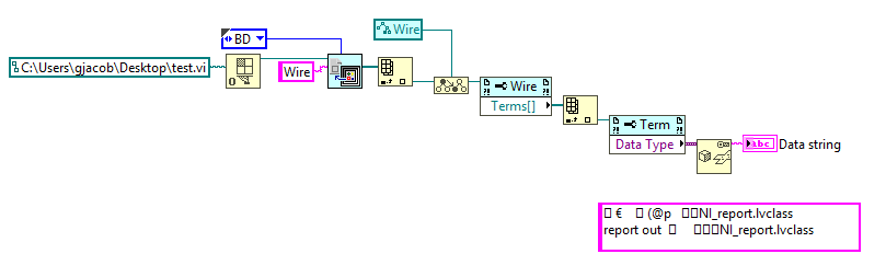

I'm not scripting expert, so I hope I didn't misinterpret the question. You can get a kind of cryptic string with the class name if you look at the terminal data type as below.

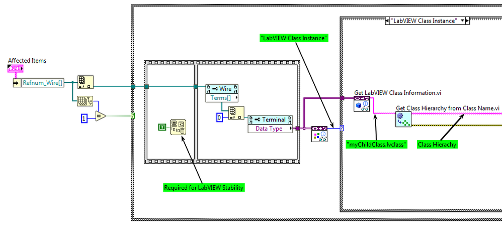

Thanks for all the responses... I've got something that works seems like should work now.
Here's where I ended up...
Unfortunately, the Class Hierachy comes back empty.even though it should not. I suspect that it is because the plugin is operating in a different application space and the class is not loaded in that space. Can someone confirm?

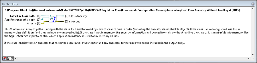

I knew DCAF loads classes and has to separate them into different buckets based on what they inherit from. I looked it up and DCAF uses the following VI from vi.lib
C:\Program Files (x86)\National Instruments\LabVIEW 2017\vi.lib\Utility\LVClass\Read Class Ancestry Without Loading.vi
