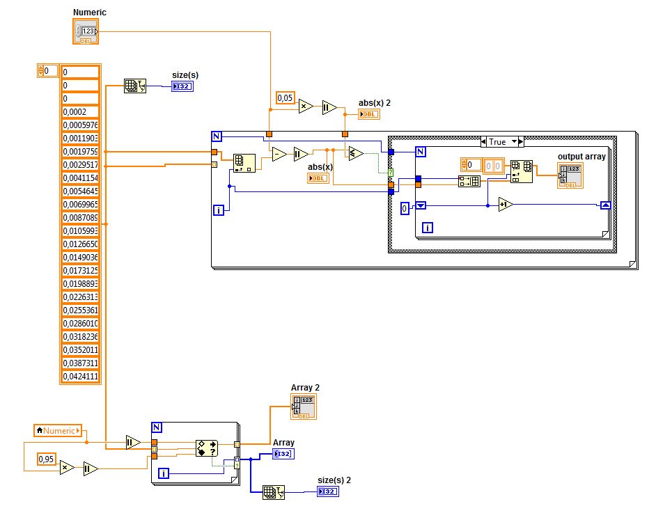

Hi!
Is there similar solution for the 1D graph and indices - upper/lower limit ... please see the code ?!
I would need the range +/- 5% from certain value and indices from array ...
Thanx!
Vasco
I don't see any 1D graph in your code. Please explain what you want.
So you want to keep certain elements and their array indices. Is the output supposed to be a 2D array?
What are you trying to show with the two independent code parts (upper and lower). Please explain.
(The upper code is completely pointless and broken. The shift regsiter belongs on the outer loop boundary and the inner FOR loop is not needed. Why is the front panel and diagram maximised to the screen?? Why do you use a local variable instead of simply branching the wire.)
Also, since the current thread is already marked as solved, you should probably have started a new thread.

Hi!
Sorry for being short with the data and explanation.
Basicly I would need to extract the data from the XY graph - at 3 different points with indices.
This would help me to explain the system properties.
So - I have settled value and what is the indices (time) at which this value is achieved ?!
Upper code is useles - I did not found the solution how to do it ?!
Thanx!
Vasco
