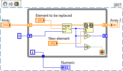

Hello, I am new to LabView and was to create some basic VI's . I was able to make a search and replace Program but now I want a counter to indicate how many elements were found and replaced. How do I do that?

You need while loop and shift registers.
In your code for loop works as many times as array length, but you need stop if already no elements.
Also your program never replaces first element
(3,863 Views)
Not Maintained Search Order anyways it will Once replaced with new number it wont alter the array values, so search can be started from zero it wont create difference.
Those controls should be outside the loop.
And of course passing the start index in a shift register will make a difference! Starting over form 0 will cost CPU cycles, which is not necessary. This will make more difference as those arrays grow in size.
(3,847 Views)
Exactly! this why I use second shift-register
(3,841 Views)
Thanks Points Taken, Suggested points are taken into consideration.
