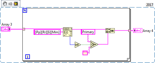

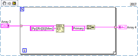

This should work, IF AND ONLY IF, Prim, Primar, Primary, is at the end of the string like in the example you posted.
mcduff
(2,725 Views)
Accepted by topic author hiNI
I did not consider the case without Prim, Primar, etc.
Then modify as such
