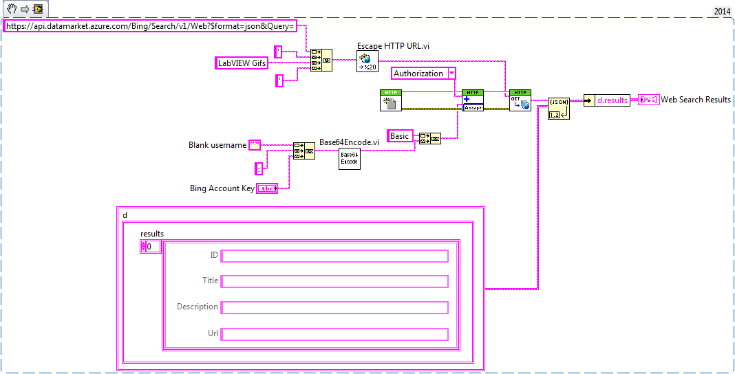

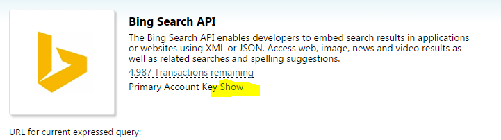

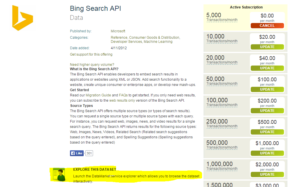

I was curious so I put together an example using the Bing Search API available here: https://datamarket.azure.com/dataset/bing/search
After signing up I clicked the "EXPLORE THIS DATASET button" and at the top of the Service Explorer window clicked 'Show' next to Primary Account Key to get my account key.
After Getting the account key I was able to use the following VI to make search queries:
The following blogspot described the authentication format used which wasn't too bad but not easy to find either: https://coderwall.com/p/d5a8cg/bing-search-api-authentication
