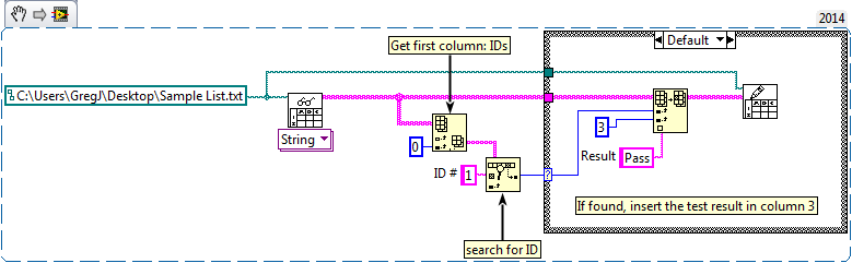

You can try something like this (this will only work for text files, you want the Report Generation Toolkit for Excel files):

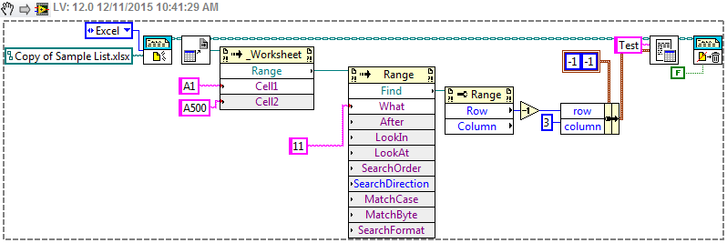

Here is how you could do it using Excel ActiveX.
