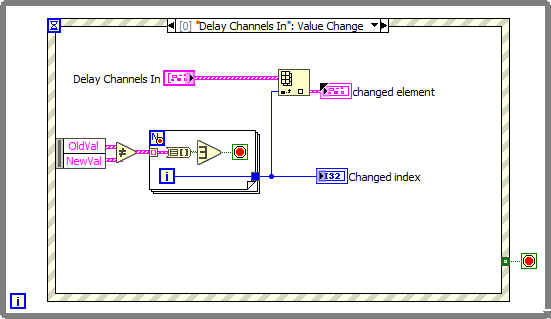

First you said you wanted to know which culster (i.e. array element) was changed, later you said you wanted to know which element was "moused".
For a value change, here's what I typically use with arrays of mixed clusters:
(4,232 Views)
