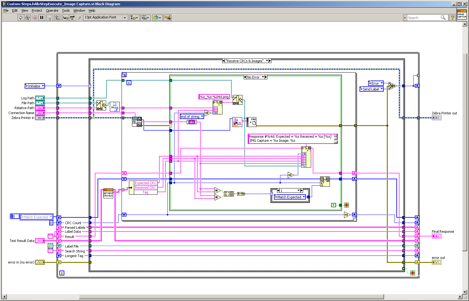

Here is a typical piece of code that we use. Notice there are lots of shifts registers.

This is the ideal situation for a shift register.  Why avoid it?  Just wire the value straight through in the false case.
