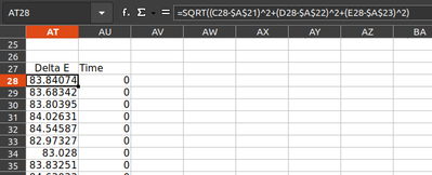

1) Is it prefered to make these kind of calculations stright in my LV code? I think, for the convenience of my client, that it will better for him to automate such calculation on the excel through my VI, meaning, when I hover over the cell that represent the average of 3 cells in the row, I'll see the corresponding excel function that is used.
e.g. when hovering over cell AT28 in the picture, I can see the calculation that gave me the result.
This will be ideal for my client as he doesnt know any LV coding, so it will be easier for him to make changes in any case, and make it less of a black box for him.

A CSV is a pure text file, and as such cannot contain macros, graphs, tabs or the like. So, if a CSV is what you want to produce you'll need to do the calculations in LV and generate a result column yourself. I don't know if you can 'trick' it by simply writing the formula as a column, it should be easy enough to test.
If memory serves, Report Generation Toolkit is now included in LV (assuming you're using a newer one). And it should give you some more options. You can also generate a document Template (outside LV) which already has macros and stuff and just enter the data.
