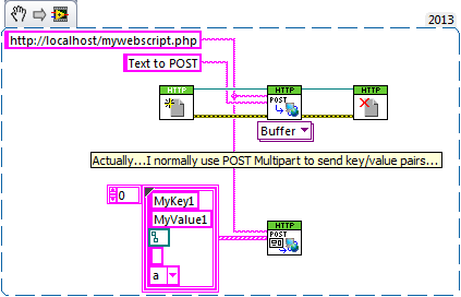

This should work as a basic example:
If you have LabVIEW 2013 or newer, there are built-in VIs for encoding/decoding JSON strings to/from LabVIEW clusters.
