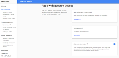

Have you tried changing "Allow less secure apps" to ON in your Gmail account settings?  It introduces a security vulnerability, but could be a temporary workaround while you get your certificates worked out.
