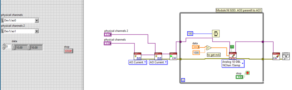

It is very silly problem that I am having. I am trying to get 0-40mA from NI 9265. I have connected AO0 & AO1 in parallel. When I operate the module via NImax everything works as it should be. However, I try to do the same through my Labview program I can not get any output.

Hi gregorian,
So you did something different than MAX…
Do you get any errors from your VI when trying to output data? If yes: which?
And why do you need to create channels and start the task in each iteration of your loop? Why don't you execute this stuff once before the loop?
(You need to write as many "data" array elements as you have channels configured in the task! For safety you should write a "0" to both channels before killing the DAQmx task…)

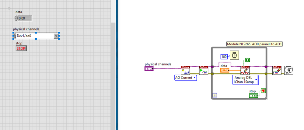

Thanks for reply. My mistake with putting create/start channel inside the loop. I do not have any errors when VI runs.
It works when I only use one channel / input.
, but when I try to add another one I can not send any out  signal from unit.

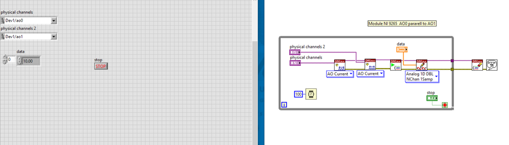

Hi gregorian,
Why don't you define both channels with just one channel constant?
How many elements are there in the "data" array?
Did you probe the error wire in the loop when running the VI?
You don't need DAQmxStart when Autostart==TRUE at DAQmxWrite…

Hi gregorian,
there are (atleast) two options to select two channels:
  • type "Dev1/ao0:1" to select two channels
  • right-click the channel control/constant to open the selction dialog, then select two channels…
