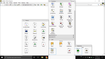

i am using a UV sensor in Arduino and i don't have problems with Arduino IDE. My problem is in Labview because i am using LINX but the sensors is not in the options.
What can i do?

I already solve it. I use the Analog read from LINX and it works. I need to check the accuracy but apparently the sensor is working.
