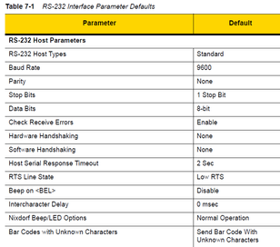

Hi Crossrulz,
I have carefully checked the manual. It describes that that Maximum no of bytes per packet are 257. Also scanner uses ACK/NAK handshaking for communication. The host serial response timeout is 2 sec.
Could you please let me know what changes I have to made in my code.
Regards.
GMatharoo

On Page 7-4 you can see the RS-232 suffix is a CR (carriage return) for most terminal types. Try that (0xD) instead of line feed (0xA) as your termination character.
