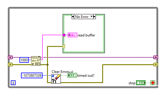

Well it is only stopping because you told it to stop on any error. If that specific timeout error occurs, you should ignore it. There is a "Clear Errors" VI for this purpose. You could also increase your timeout value depending on how response you need the loop to be.
I would get rid of "bytes at port" as Crossrulz suggested, and just do the VISA read. Then you can see if number of bytes read is >0. If it is, update your read buffer, if it isn't, then do nothing.

Your timeout is set to 3 seconds.  Are you sending new barcodes to be read faster than that?  If you don't pull the trigger fast enough, you'll get a timeout.  Since your error wire has a shift register on it, once you get an error, it will prevent all future runs from reading.
It seems you didn't look at the advice about clearing specific errors.

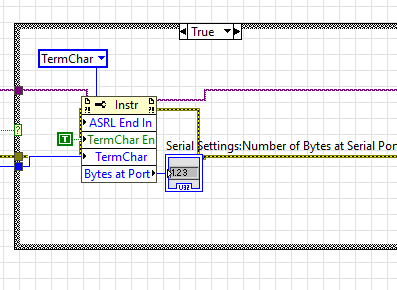

Hi Gregory,
It works fine without error case structure.
I have to count the output from the scanner. I was using the " Bytes at Port " property node.
If I add one more property to input property control. It doesn't count any input from the scanner. What to do?

I don't see how the picture you posted relates to the picture Gregory posted.
And your picture is incomplete.
You should not need Bytes at Port 99% of the time.
Have you seen Crossrulz' VI Week presentation ?
