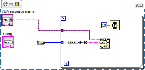

Here is an example .. i used wait instead wait until next ms ...   or try a timed loop ....  however with the OS and it's serial driver the time delay may vary anyway...
with some OS driver tweaking (buffer size, priority ,...)  that could be improved but it should run like that.
(hope I don't end up in the Rube thread with that solution :D)
