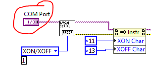

Hopefully you added the COM PORT input that I forgot to include!

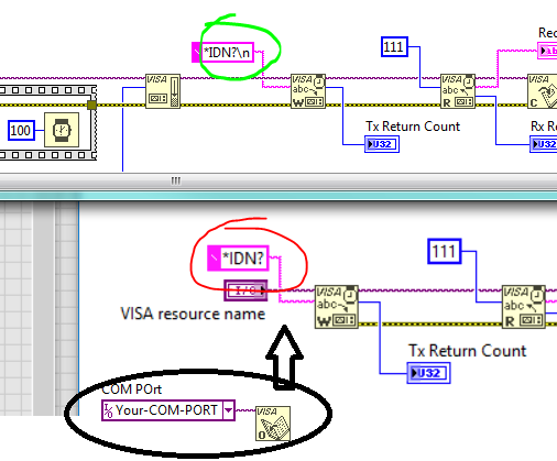

Hi Frozen,
I am using USB to RS232, with LABVIEW 2019 on Windows 10 and tried different adaptors.
After running your VI I modified it slightly and got an entry in the Receive data (attached), I not sure if that's a step in the right direction. Just to flag the same observation again I get a chirp from the instrument every 3 runs which might be significant?
Thanks for help Frozen.
Message 32 of 33
(1,308 Views)
A chirp from the instrument usually means an error has occurred. Have you checked the instrument's menus for an error msg?
By *not* including the "/n" in the command, you have sent an un-terminated string to the instrument and it is waiting for more input.
Also, if you are not configuring the port, at least put a VISA Open before the first write command.
You really need to verify that hardware connection is correct.
