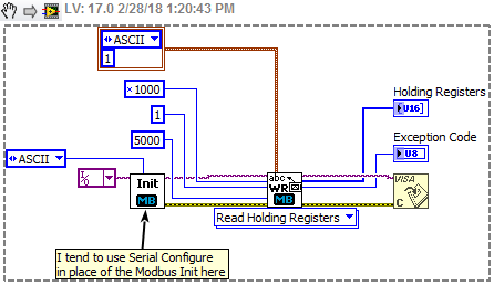

It looks like your string to write should be     :010310000001EB
It would be really better if you used a modbus library.  It takes care of the checksum for you.  I'm attaching a VI snippet of the older library I generally use.  I was able to get the string by digging into it deeper and seeing the end result of what is written out.  (Newer modbus libraries seemed to be locked from getting into the more detailed subVI's.
Note that I made the constant for the address set for hex display radix.  The manual says you are looking for 1000H address (seems like they've already dropped the 4 and made it a 0-based index.  Actually, the only time I see an address with a 4 in front is if they are writing it in decimal.  So holding register 1000H would show up as 404097 in other manuals.)   If the address was listed in the manual as a decimal number, it would have been 4096 in a decimal display of that constant.
Make sure your device is in ASCII mode.  But I would make it RTU mode and use that in my LabVIEW code as well.  It is a little more efficient (half the bytes need to be transmitted) and mainly all of the devices I've worked with were set for RTU mode.  The advantage of ASCII mode is that the strings being written and read when you drill down into the communication are all human readable.
Example_VI_BD

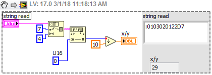

Don't typecast to double.  You have a string of hex characters, you need to convert that string to an integer, then divide by 10.
You need to parse out 4 characters.  For the last one, 0122  Read that as hex and that is 290.

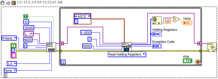

Programm
The LRC calculations are done within the modbus library.
Here is the full program that would do it for you.
