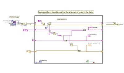

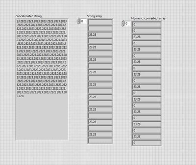

I trying to use VISA to talk to an IPS power supply.
The communication now works perfectly but I’m struggling to parse the data in a suitable format.
I require just the voltage output but it seems to be interspersed with zeros.
Any suggestion as to how I overcome this issue.

Hello, Simon-lee.  I see that you got @crossrulz, the Forum's expert on all things Serial, to help you with the VISA side of communication with the IPS-603.  What might (?) now be happening is that you are getting responses back, but maybe are parsing the returning data incorrectly.
Here's my suggestion:  Make a copy of your Volt-Read program.  Delete the While Loop (so you only do one read), and delete everything below the Error Line (no parsing).  Attach a String Indicator to the Read Buffer Output, set its "Appearance" Property to "Backslash Code" (so we can see \13 and \10, if present), and run the Program.  Expand the String Indicator so we can see the entire String.  Note that if it doesn't "look like a String", you might need to connect a "String to Byte Array" function to the Read Buffer output and display (perhaps in Hex) the resulting Byte Array.
One other thing to try is to see if things work better if you use <LF> (0x10) instead of <CR> (0x13) as the VISA termination character.
Sometimes just seeing how the data actually look can be a great help!  Since it is either going to be a readable (I hope) String or a short list (50 elements, at most) of U8s, you can even attach a "picture" (I know, I usually cry when pictures are attached) and I'll be happy ...

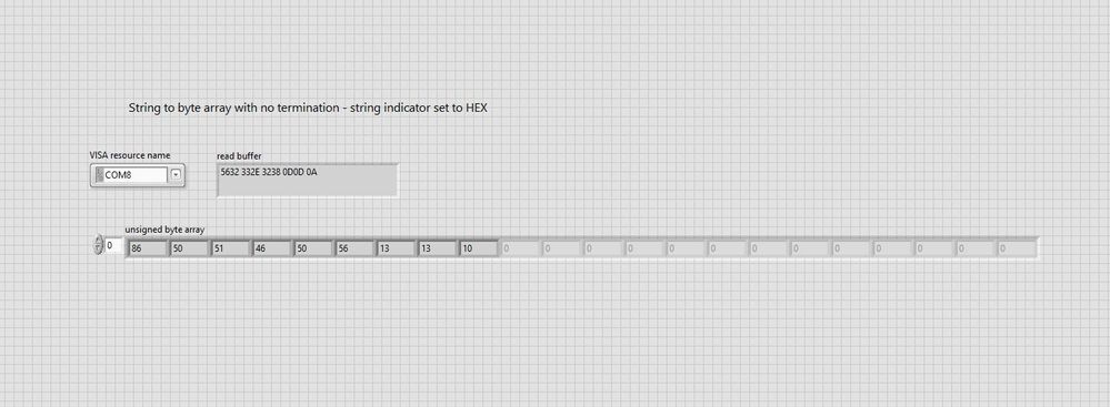

I have added some addition snips - one with the original termination character - and a second with no termination.
On you second suggestion of subsituting <LF> for <CR> I returned to my original vi and made the change. Hey presto it works, I really happy it works. I have also added some additional HEX and \ codes if that might explain why.

String%20to%20byte%20array%20with%20no%20ternination%20and%20HEX
I find it weird there are two Carriage Returns.  It is like the supply is terminating the response with just a Carriage Return (which is why I previously told you to use that as the termination character) and then appending a Carriage Return and a Line Feed to complete the message.  Therefore, you should be using the Line Feed as the termination character.
EDIT:  From the Manual
"The power supply has 25 commands available. Every command is end up with (ASCII 0Dh or ACSCII 0D 0A acceptable). The return message of the power supply is CR/LF (ASCII 0D 0A)."

V\r  = V23.28\r\r\n
L\r =  V23.28A0.000W000.0U60I2.11P127F000010\r\r\n
V\r =  V23.28\r\r\n
A\r =  A0.000\r\r\n
W\r = W000.0\r\r\n
U\r = U60\r\r\n
F\r = F000010\r\r\n
All have that odd double \r - I guess its just one of those undocumented idiosyncrasys. It was a cheap unit and its quite slow responding (baud rate is only 2400) so you get what you pay for. On the plus side I can talk to it now, thanks to you and others on this forum.
