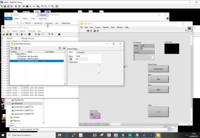

the DLL was edited to remove the null value.
I can see in DebugView that an Event is generated when I press the "Raise Event" button.
The problem I have now, is that the code in the Callback VI does not execute in response to an event.
(1,474 Views)
It executes, but you cannot see it, because the execution mode of the callback VI is set to preallocated clone.
Either put an invoke node to open its front panel or switch it to non-reentrant so you can open the instance from the project.
