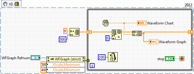

If your data is coming at regular 250ms rate then you can use a Waveform Chart insteas of an XY Graph. With a chart you feed it a sample at a time and it keeps its own history buffer (set to 3600 samples for 15 mins at 250ms). Set the X axis multiplier to 0.25 to get the axis to display seconds.
However, if you are continuously adding new samples then you will not be able to scroll back through the existing data (at least not that I have been able to manage so far). If this is essential then you can create your own history buffer of 3600 points in an array and store it in a shift register - add a new one each time round the loop and delete the oldest. Then feed this into a waveform graph. You can then programatically set the scale max and min to set the range, and use the scroll bar to scroll.
This snippet shows both a chart and a graph with a separate buffer for comparison.

Sorry for the delay in my response to your prompt reply.  I had similar Idea though your is much cleaner.  The question I had using this method is rather or not the data that is push into the array after all 500 slots are filled truly taken out of memory.   I don't know enough on LV memory monitoring tools to know how to check.
