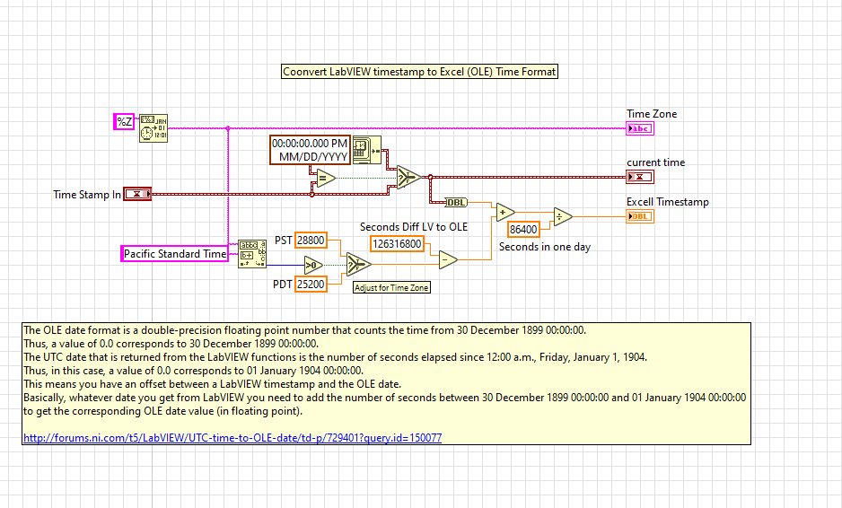

An Excel time is NOT text you need to save it as a floating point number, then you can use Format Columns function in Excel to show the time with milliseconds.

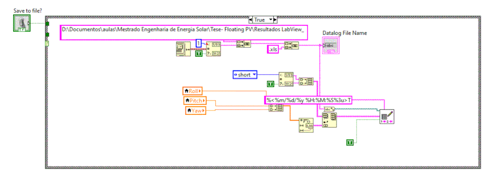

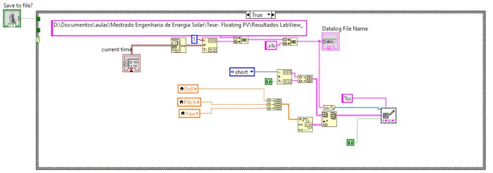

but what should I record as a "floating point number" you can draw on this impression that I leave here please:

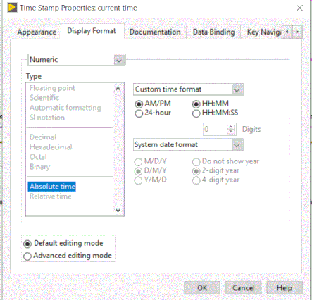

i cant put in the floating point  ....

Since you are saving it as text file,  you need to use the a better number to string conversion.  Don't use that particular Date Time function.  Use Format into String with a format of %<%m/%d/%y %H:%M:%S%3u>T
If you expand it further and add %.2f, you can put all those values together in one shot.
(2,257 Views)
