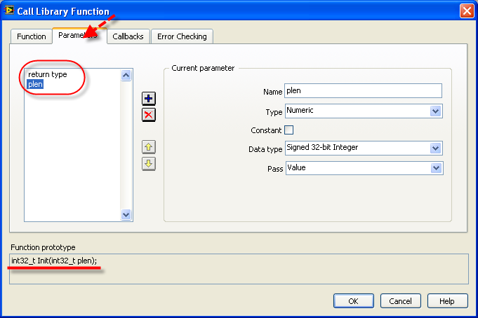

When I test it in LV, it popup message said I need to set parameters as the screenshot.
May I know how to do it.

Take a note, that the similar message appear, if you have defined parameters, but then function name was changed.

You also appear to have some function name decoration going on. I assume you have an export table?
(3,838 Views)
Thanks, I tried to add the parameter, but it report a error and the function names looks strange, not like you shown.
Any where need to setup or the any name decoration I need to do. May I know how can I do it.
(3,825 Views)
You should look over these articles:
Writing Win32 Dynamic Link Libraries (DLLs) and Calling Them from LabVIEW
Debugging Shared Libraries and Calls to Shared Libraries
Function Not Found in Library Error When Using the Call Library Function Node(specifically the section titled "Function Name is Decorated")
