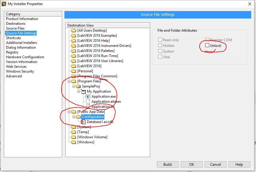

Hi.
I recently created an application updater in LabVIEW.
I was able to overcome the Windows "Program Files" permissions problem by checking the "Unlock" checkbox in the "File and Folder Attributes" area of the "Source File Settings" page of the application installer creation utility.  I checked this box to unlock each of the folders that I will want to be able to update in the future. See image below.
By default, folders within the [Program Files] and [Public App Data] folders ("Program Files" and "ProgramData" in Windows) have the "Unlock" checkbox unchecked, and cannot be written to except by an administrator.
After making this change and executing the installer, my file permission problem, the dreaded Error 8, was gone.
I hope this helps!
Configuring the installer to allow an application to update Windows protected folder files.Configuring the installer to allow an application to update Windows protected folder files.
