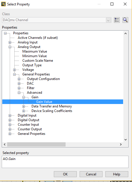

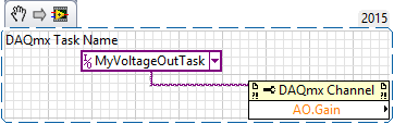

Ain't that sweet!
(3,912 Views)
Thanks Jeff! That seems an advanced property setting in DAQmx palette. I was thinking whether setting the voltage range in the DAQ assistant express VI would set the gain automatically. If that is not the case, I will go try your approach.
