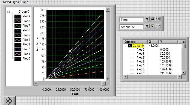

I have added a screenshot here with yellow highlights to show  Y-scale ( left on the graph) and Cursor-Y (right on the cursor legend)
The number of precison digits shown for each of these numbers are both four digits. I want the Yscale digits to be zero and the Cursor Y to be 4 or any number.

Well, BlessedK, you have once again attached a picture, but no VI, so I cannot determine how you have set the Y Scale Display Format.  I'll note in the VI you attached most recently, it was set to 4 digits of precision (which is what your picture shows), despite your statement that you want the Y scale to have zero digits of precision.
My suggestion, once again, is if you want the Y scale to have zero digits of precision, set the Y Scale to have zero digits of precision.  If you set it for 4 digits, and want it to have 0, don't complain when it shows you four digits.
The precision for the Cursor, as I've explained, is another matter, one that you can, in principle, manage yourself by creating your own display for Cursor values.  One might ask, however, why a cursor should have a precision four orders of magnitude higher than the data being charted, but that an argument about "Do you know what you are doing", as opposed to "Do you know how to do it".

Thanks Bob. My question is simple. On the vi I sent earlier. Can you set the Yscale digit to zero and set the cursor Y precision digits to four ? That's all I am asking. I have long resorted to placing a fresh graph and gotten what I wanted. But I just want to establish that we both agree that if the scale legend has been adjusted, ( or fiddled with in your own words) that it can't be restored to the default.

@Bob_Schor wrote:
The precision for the Cursor, as I've explained, is another matter, one that you can, in principle, manage yourself by creating your own display for Cursor values.  One might ask, however, why a cursor should have a precision four orders of magnitude higher than the data being charted.
I don't know about htis particular case, but LabVIEW has some annoying habits of bunching display resolutions together. So even if the markers on the axis should show no decimal digits for cosmetic reasons, the cursor display still should. You don't want cursor values quantized to the marker resolution.
A probably related, but to me much more annoying thing is that if you export graph data to the clipboard, the output format will use the axis marker format and you could end up with severly truncated data. Se my old comment here. Somebody even made it onto an idea, just kudoed. 😉

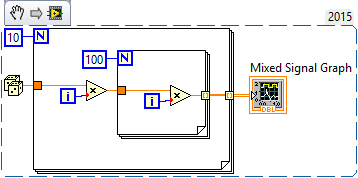

I took the VI that I'd downloaded from you (with Y Scale Display Format set to 4 digits of precision), changed it to 0 digits of precision, ran the VI, and got this:
Notice that the Y Scale has ... 0 digits of precision.  Here's the VI (as a Snippet):
It should look identical to the one you posted.
