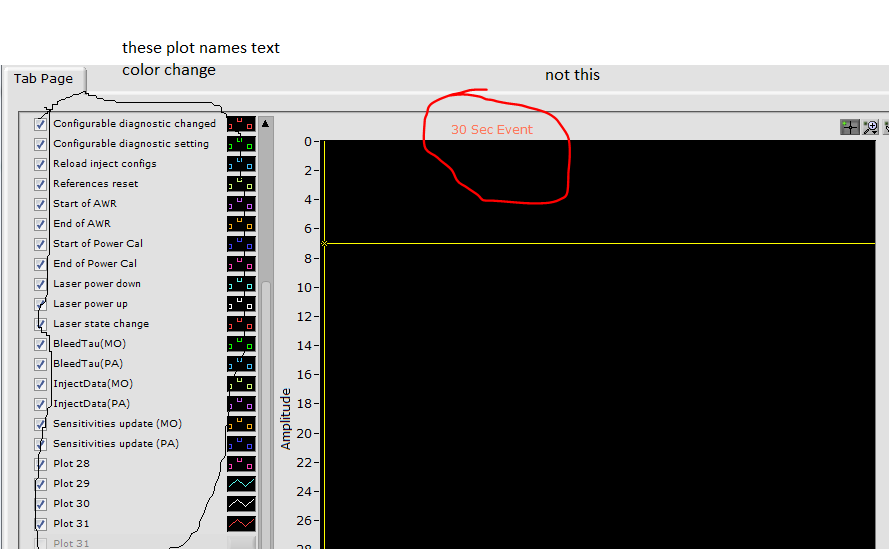

this changes main plot label color not the plot name color in the plot legend. if i have multiple plot names how can i change those
(5,046 Views)
There is actually no way in LabVIEW to programmatically change your plot legend text. Since they are all being referenced from the same object, there is no way to individually change the color of your legend text.
