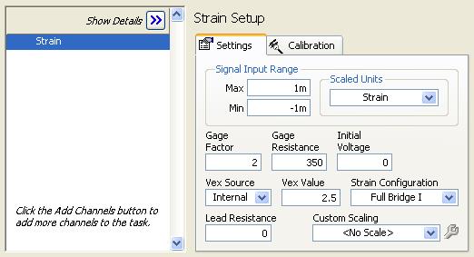

Are you setting up a strain task?  If so, it should be pretty straightforward to set the properties of your load cell (gage factor, gage resistance, etc.)  in Measurement and Automation Explorer (MAX):
Once you have your settings correct, you can create a new scale by clicking on the Custom Scale dropdown and selecting Create New...  This will allow you to create functions or tables to map your prescaled values to the correct scaled values.
