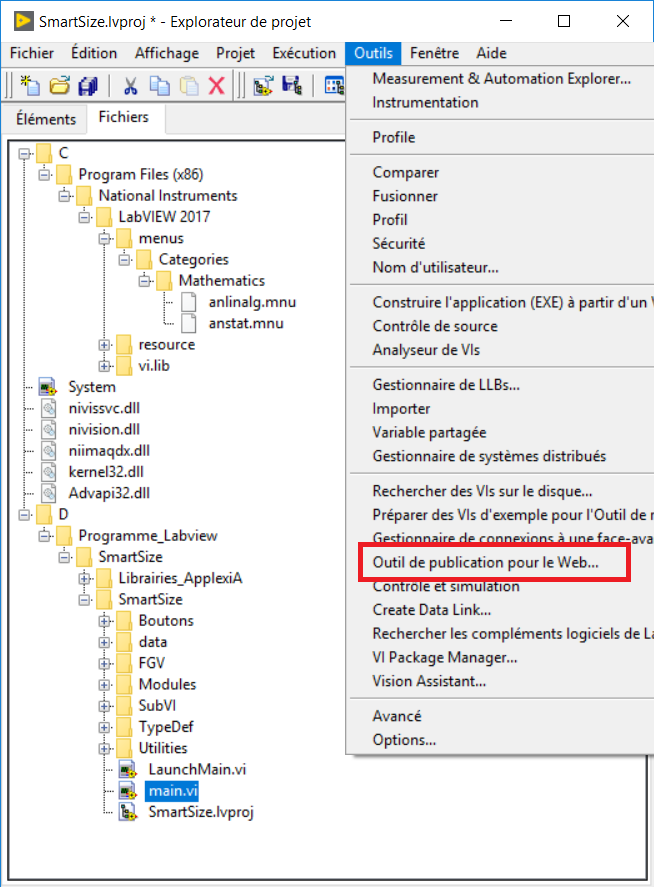

I want to share My vi in the Web . it work with the Following tool in localhost  . Now i want to do in another PC . So i copied the Url and pasted it in the internet Explorer of the Client machine . It didn't work can someone tell me what can be the problem ?

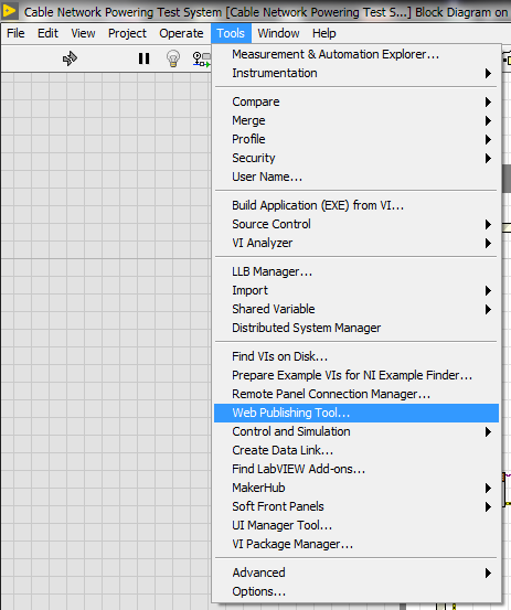

It has been a long time since I used it but you have to run the "Web Publishing Tool" (That is what the English version calls it).
That will lead you through setting up the LabVIEW web server to share your application over the web.
