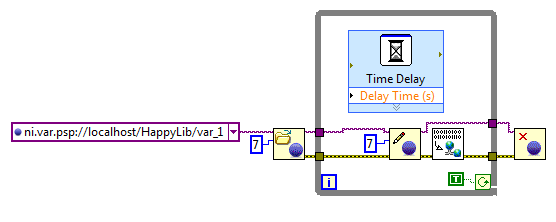

Here's my situiation:
  • On the one end I have a simple LabVIEW VI that sets a shared network variable (int32) in a loop.
  • On the other end there is a small C++ application I wrote, which measures the time between variable updates.
  • Both are running on the same computer (which is pretty fast BTW)
The problem is that I can't get the update rate any faster than 10ms. This seems quite slow and is not enough for my planned use case.
When I add more variables the cycle time still stays at 10ms. This makes me believe that this not a bandwidth issue, but rather something else. Thus a better performance should be possible...
What I tried:
After reading all the documentation and lots of threads I tried the following things:
  • Use a small delay in my VI sending loop (1ms). Without this LabVIEW seems to "choke"
  • Use the Flush-Block right after the write block to send immediately
  • Open and close the variable connection outside of my sending loop
Here's what my VI looks like:
My sending VI
Message 1 of 9
(5,810 Views)
Boris,
LabVIEW temporarily stores the data that you write to a shared variable in an 8 kilobyte buffer. LabVIEW sends that data over the network when the buffer is full or 10 milliseconds have passed. Because you incur overhead each time you send a data packet over the network, this design increases throughput by decreasing the number of data packets you send.
However, this design increases latency when you write less than 8 kilobytes of data to a shared variable. To eliminate the 10 millisecond delay and minimize latency, send all shared variable data over the network immediately by using the Flush Shared Variable Data VI after you write to the shared variable,[...]
So far from the LV help regarding the Flush function in your code. It seems that Flush does not perform as described in your use case.
I am wondering about your Time Delay ExpressVI. Why dont you include it in the execution chain e.g. between write and flush (use error cluster for this!).
You loop never exits. So your close connection will NEVER execute. Please change that. Stopping a VI with the "Abort" Button is a no-go!
Your code does not include any benchmarking. How do you know that this loop executes with 10ms delay each iteration?
Is it possible that your C++ application encounters the 10ms delay during reading?

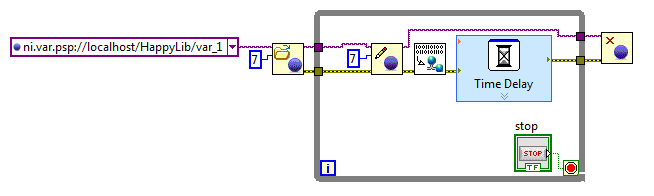

Hi Norbert,
I changed the VI according to your suggestions (they make total sense).
  • The Delay (1ms) is now in the execution chain
  • The VI is stopped via a button
But the slowish behavior (10ms cycle time) still exists.
My C++-Code is as simple as it gets. It sleeps all the time and only reacts when the callback from the NI-Thread comes in. In that case the current time is taken and compared to the last time.
Regarding the VI: I guess the VI runs faster than 10ms. But that doesn't mean that the variable engine transmits at the same speed right? So benchmarking wouldn't help much here... (would it?)

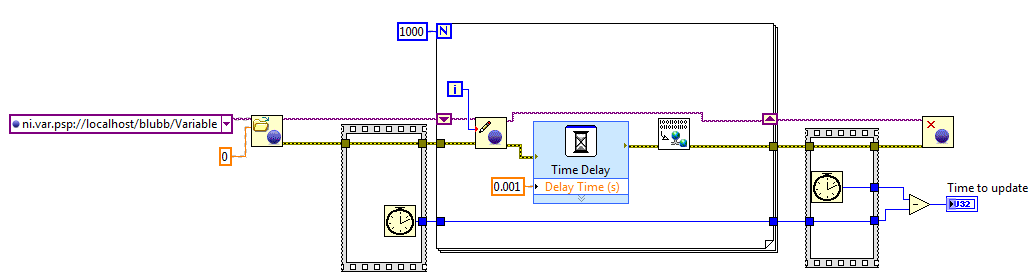

Hmm, i tested this using LV 2013 and the Distributed System Manager 2013.
I cannot see any delay when using a shared variable which is not buffering (double scalar in my test).
The iteration time of the loop was 1ms and it took the DSM to read 1000 values only a little more than 1s.
Here a screenshot of the code, which is quite similar to yours:
So obviously, the SVE (Shared Variable Engine) does not wake up your C++ code in the time pattern you expect. Have you checked for CPU load? Thread locks?
And also please verify the speed with DSM as well....
