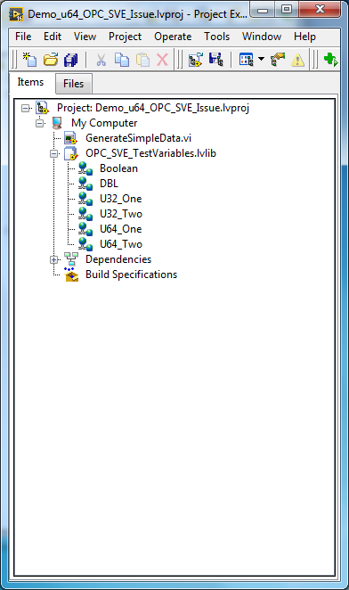

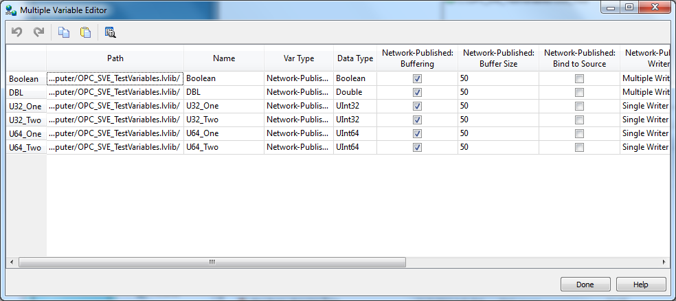

Rey - certainly.
Here is a simple example project with Variable Library and a Data Generator Loop to push data to the SV that you can then try and see in an OPC Quick Client.
I have no trouble adding the NI Shared Variable Engine.1 Server in the QC then adding a folder named "Test" then adding items - finding the Variable Library.
Its when I click on the Variable Library in the QC to see the tags available - the U64 items do not show, but the Boolean, DBL, U32 show up.
Make sure to either manually deploy the library or run the VI first before trying to add the variables in the QC so the library is deployed and the variables exist.
