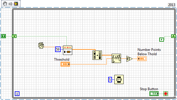

POC Code for doing this with Data Queue pt by pt
Note there is only 1 buffer alllocation for the data (Sort operates inplace)

Maybe fixed size queue and Lossy Enqueue Element will work also. You can always get all elements in the queue with Get Queue Status.
I have no idea if this is faster than Data Queue Pt by Pt.

Thank you! I worked with what you posted and tried tweaking things around to what I would want I seem to have the hang of it. The system is currently running so I can't implement it at the moment but I'll try later today or tomorrow morning and update whether I was successful.
