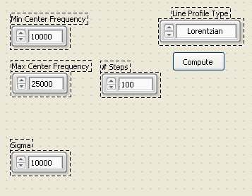

As far as I can see (LV 2013), there is a missing feature in LabVIEW, whereby, when you select multiple numeric controls, you cannot show/hide their increment/decrement buttons:
Here I have 3 DBL, 1 I32 and 1 enum, but this holds for any combination of numerics. If I right-click any of the selected controls, I have access to only two items under "Visible Items":

Good find. I agree that the current behavior is undesirable. Here's what I found:
I think it comes down to a class issue. 'Numerics' do not have a property for "Increment/Decrement Visible". However, this property is available for 'Digital' and 'NamedNumeric', both of which are siblings under 'Numerics' (and these are what you were trying to alter at the same time). So as far as LabVIEW is concerned, it's 2 different properties for 2 different classes... which just happen to have the same name.

As I said, if I select two DBL controls, I still can only access two items under "Visible Items".
So I am not sure how to understand your analysis, as it would seem that nothing should prevent LV from pulling all common properties from those two identical controls...

Strange, I'm not seeing the same behavior. I only see the problem if at least one DBL and one Enum are selected. If it's just two DBL, I can see all the common properties. I'm in LV 2011 SP1.

Works as I said in LV 2013. Bug must have been introduced in the meantime...
