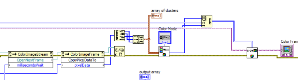

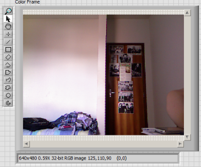

Well, this picture is a program I made to capture and display in RGB U32:
And this is her programming:
This programming worked perfectly, and based upon

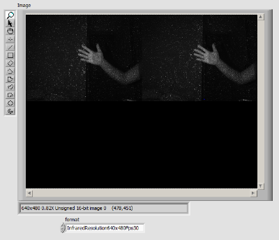

did not work the first time, on the screen where the image appears
got 2 identical image and dividing the screen.
This is the result:

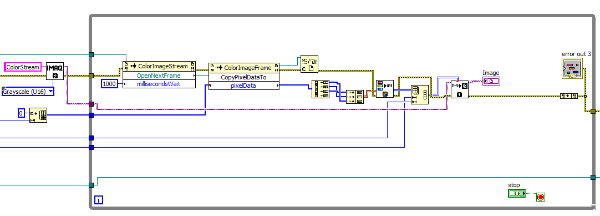

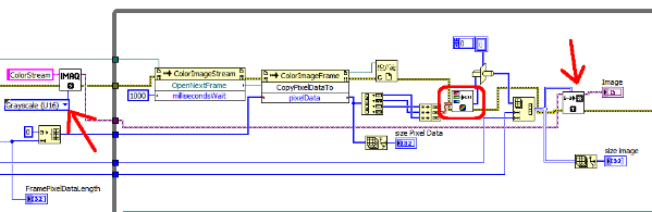

To improve the image was divided into 2, I made an adjustment of a matrix,
this matrix was leaving the format and converted U32 to U16. It worked well, but

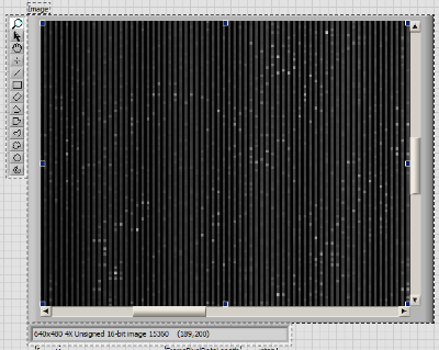

the image has vertical lines are totally black and very disruptive visualization.
The image:
Zoom in the image:
That was the programming used in the image above:
Viewing the image above we can see that I start with IMAQ U16 grayscale (grayscale Usigned 16-bit), but the square
vermelo I use a function "1d array to color" and I think that's what this going wrong, I searched and did not find any function that would "1d array to gray" (not sure if there is). Soon it comes out of a wire array and converted U32 to U16. But that did not work, it worked, but the picture was bad as mosta the figure above.
