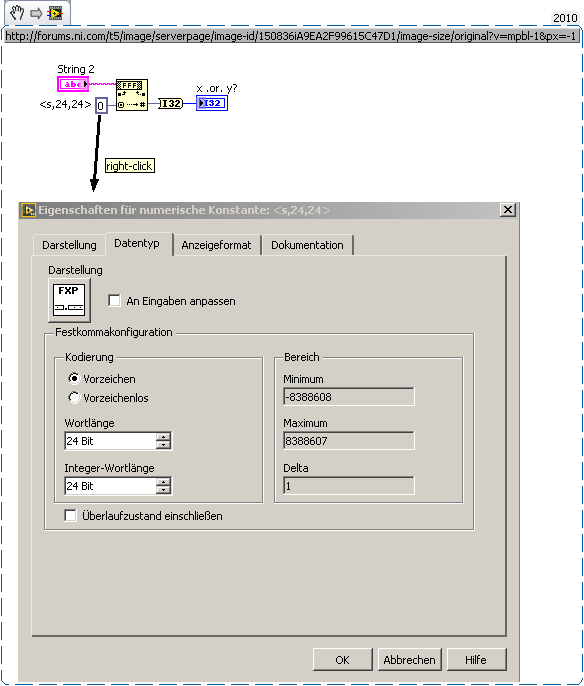

I think I found a good, relevant example here, but I can't figure out how to recreate the gray constant - I don't know what the gray constant/wiring means.
it's a fixed point constant.

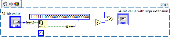

I was able to change to the floating point constant and then experimented with the code. Unfortunately, I couldn't get this to work. Here it is in 2012 if anyone is interested:
However, I developed a different solution that seems to complete my sign extension correctly. It might be a little clunky, but I think it works. If you want to use a different string length, just edit the minimum field width of the control (named 24-bit value), change the 32-bit constant to have the same number of zeros as the total length of your string (for example: if your string is 20 bits long, the constant should have twelve 1's followed by twenty 0's "11111111111100000000000000000000"), and change the index constant of the Index Array function to be the element of your MSB (for example: it should be 19 if your string is 20 bits):
