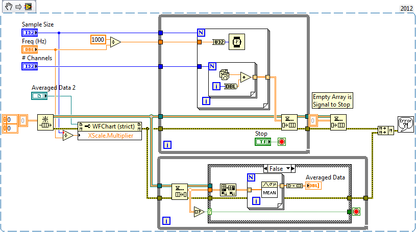

Raghunathan,
     I'm sorry you have such a low regard for elegance and correctness, and that you feel that "Good Enough is Good Enough".  Maybe, in the future, you will consult someone who knows and understands LabVIEW and simply tell him (or her) what you want to do and let them do it for you.
     However, if your goal is to (a) collect data from N channels at frequency F (in Hz), but to display the average of M points (so for every M points you generate you plot 1 point, the average of the M points), here's a good way to do it:
  • Create a "Producer Loop" that generates the data by setting your Sampling Device to give you M Points from N Channels, sampled at frequency F.  This should be a 2D array (M rows of N columns).  Put this in a Queue and repeat, over and over, until the Stop button is pushed.
  • After exiting the Producer Loop, send one more empty 2D array (you'll see why in a moment).
  • Create a parallel "Consumer Loop" and feed it the Queue used by the Producer Loop.  Dequeue the Data Array -- if it is empty, we're done, so release the Queue and stop the Consumer Loop.
  • Otherwise, we need to "Consume" (= Average and Plot) the data.  We need to transpose the M Points by N Channels array to a N Channel by M Points array.  Feed this Array to a For Loop (which will loop over the Channels), compute the Average o the M Points, and output this Average.  We want to plot this (single) point from all of the N Channels, so pass it through Build Array to make a 1 by N Array, and plot this.
Here is a Snippet in LabVIEW 2012 that lets you simulate all of this (it generates points at the frequency you specify, max 1KHz).  I also scale the Plot so that Time is in seconds.  [This didn't "translate" well for the Snippet -- I actually used an Averaged Data Property Node there].
This, I think, does what I understand you really wanted, namely to have a display that shows the "average" (at a slower plot rate than the data).  You'll notice that each Channel has a different offset, so when you look at the plot, you should see 16 lines, looking more and more smooth as you increase the Sample Size.  You need to specify the parameters before you run the code, since the principles of Data Flow (on which LabVIEW is based) will ignore changes you make to the Controls once the program is running.
Bob Schor

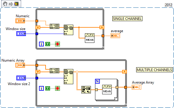

Here's a simple subVI that does it all in-place (unless the number of signals or the number of averages changes).
See if it makes sense to you....
Message 13 of 16
(11,097 Views)
Yes it does. Very compact and exactly does what is required. Thanks for sending the Sub VI as well as an example using it. Its getting to be clear as to what compact code is all about !!
Raghu
