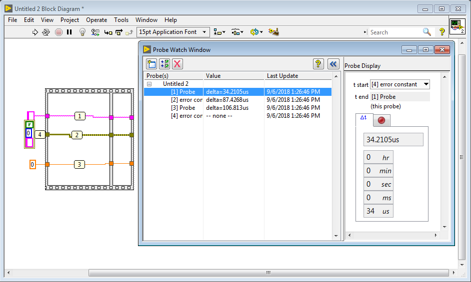

I just drop the timing probes along my error wire, and see the dt between the execution of the probes. I usually have error wires at least enforcing data flow throughout my VIs.
3 seconds of setup, 0 seconds of cleanup (just close the VI or probe window). 97% success.

  • Tab 1 shows you the elapsed time since the previously executed probe.
    • Mark a probe as t0 to just ignore the bogus value returned (the first probe can't have a dt). Check the t0 check box to do this.
  • Tab 2 lets you set a conditional breakpoint, based on whether or not the dt was greater than a particular value.
  • The time deltas are based on execution order of the probes, not on placement order.
  • The microsecond version of the probe only works on Windows.
    • Obviously, take the microsecond values with a grain of salt, since we are talking about Windows, here. Useful for an order-of-magnitude idea of sub millisecond execution times.
