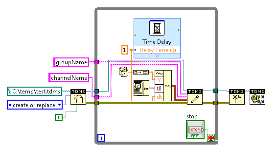

I make a simple VI example to show how to use TDMS Write. You might replace the "Random Number (0,1)" with your real pressure data. Attached "Write TDMS File.vi" is created by LabVIEW 2012 (http://www.ni.com/trylabview/).Write TDMS File.png

Thanks. I'm trying to replicate the example you posted. Can you tell me what the object wired just prior to the top terminal of the build waveform function is called? I'm in labVIEW 8 and I can't find it.
Message 3 of 14
(5,519 Views)
Build Array.  It is a growable function.  By default it has 2 terminals.  It can be shrunk down to just 1 terminal.
