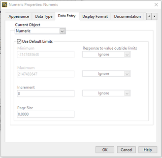

The loop was just to set a random selection on numeric range limit.
And, I was cautious on the number limit too, christian. As far this default value
exceeds the I32 control both in numeric control and Array control works fine.

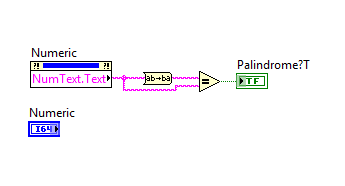

The solution goes something like this.. Am just thinking other possible sol. too, to just iterate the claim Smiley Wink
As in place of 3 functions, we reduce them to 2 functions by removing decimal string conversion and using the NumericText. Text property node. Thereby, taking string form of a number from itself!!
That is still three function, one being a very expensive property node! Make the input a string and get it over with. As a bonus, it will work with almost any number of digits and even detects in any random text string is palindromic at the same time.
As long as you only enter numeric characters, there is no difference to the other code.

2 functions (1 p-node)
