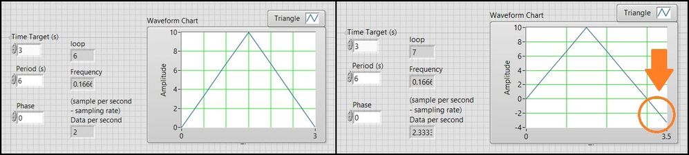

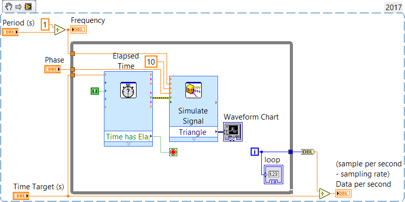

I'm building this Simulate signal VI to generate waveform within a dedicated period of time determined by Elapsed TIme express VI both in the same loop. So that I can control exactly the output signal period for further application.
For instance, the simulation signal period is 6s and time elapsed for the while loop to run is 3s, therefore I should always obtain 1/2 period signal generated when the while loop terminated. But somehow, the Simulate signal express VI is by chance over generate extra 1 point that ruins the expected output signal.
Please help me to fix this,
Thank in advance.

Don't do it that way!  Get rid of the Elapsed Time Express VI, the Simulate Signal Express VI, learn about Waveforms and use the Waveform Generation VIs, and do a little arithmetic to generate precisely the points you want.  It helps to understand what LabVIEW means by a Triangle Wave, to understand what Frequency and Phase mean with such a wave, and a few other things that I don't think you fully understand.
Bob Schor

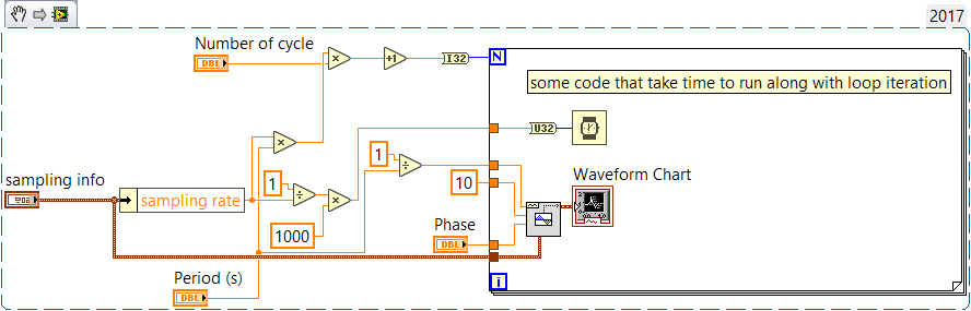

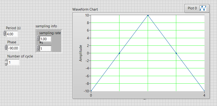

My idea is that I need the loop to run simultaneously with the point generation process. Because some code needs also to proceed inside it at the time between iterations.
So I use the sampling rate to determine the loop iteration time, then together with the period (1/frequency) to control the spacing between points and the number of the cycle that I want to generate.

Everything is fine except for your plot.  You are updating once/second, presumably by sending values to a D/A converter.  This is the output you will get:
The value is 0 for a second, then 1, then 2, then 1, then 0.  Is this what you want?  I suspect that it is not.  If you are generating a signal digitally, you need to think about the update rate and how you go from one point to another.

Yes, that is exactly what I need, except the number of sample per generation is 1.
I'm controlling a thermal bath by sending this kind of signal to modify its temperature that following the triangle or sine wave. The update rate and the way it goes from one point to another should be even lower (longer) more or less.
