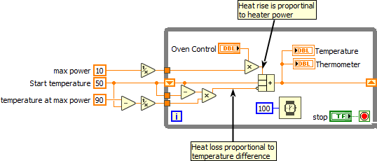

Yes, of course, but that something you should solve, but first you need to define the problem better. What does the control actually do? Does it (1) just regulate the % power to the heater or is there (2) some on/off thermostatic control that automatically turns a fixed power heater on or off depending on a setpoint set via the control?
Case (1) is easier but you won't get an overshoot.
Basically you would keep the current temperature in a shift register and simulate the heat loss by subtracting a suitable amount that scales with the temperature difference above 50. At the same time add a suitable amount scaled with the heater setting. Adjust the scale factors such that temperature asymptotically reaches 90 at full power. Run the loop at a reasonable rate. (picture is a simple draft that can give you some ideas).
Case (2) Should have a control that sets the desired temperature (NOT heater power). You could do with an on/off heater control depending on setpoint, deadband, duty cycle and delays. You don't need any express VIs, just a simple state machine, keeping track of the various metrics.
