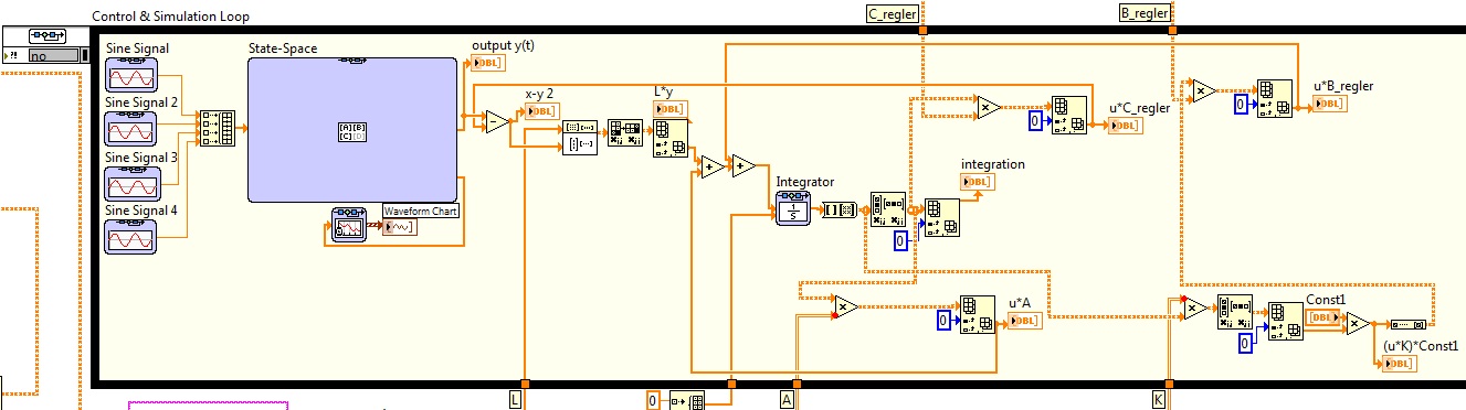

I am working on a regulation in a Control & Simulation Loop. I have created a state space model and an observer in it.
Now i have implemented nearlly everything but now the simulation doesn't stop.
At first here is an image of the .vi when it still works:
But this isn't the final result i want to have.

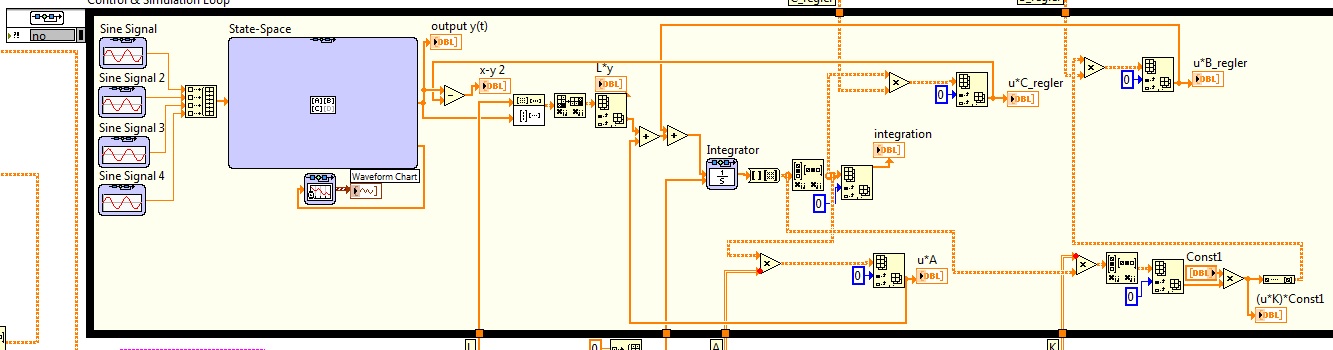

I want to connect the output of the subtrahation (x-y 2) to the input of the outer product.
You can see it on the following picture:
If i do so, my simulation continious and never stops. The simulation time is still set to 10 sec.
Attached is the .vi. I hope someone can help me.

I didn't use the halt funktion.
I just set the simulation time to 10 seconds. If the blocks are wired like the first picture shows then the vi works well and stops after this 10 seconds.
The confusing thing for me is, that the simulation doesn't stop automatically if the blocks are wired like the second picture shows.
