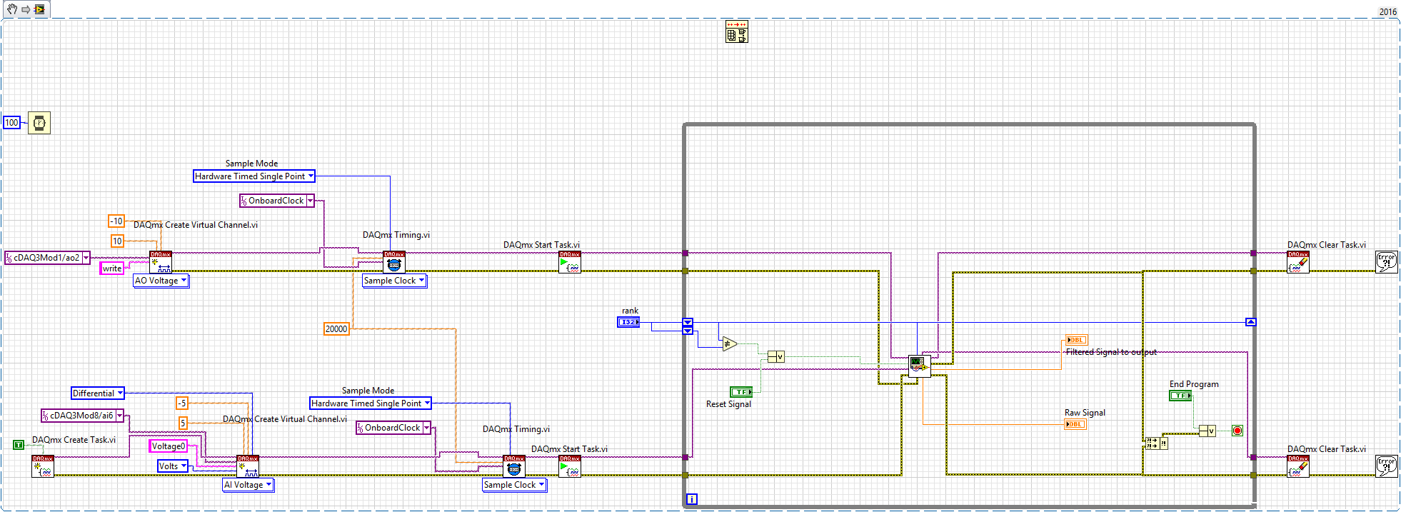

I have a cDAQ-9178, with modules NI 9263 and NI 9205. I am trying to read a variable waveform (from a hall effect sensor), do some basic filtering or alterations, and then output that new waveform as fast as physically possible.
I need some help to determine if a) This is possible b) How to do it.
I have attatched my VI snippet (relatively new to Labview and these forums so let me know if I did something wrong). I have tried a few dozen alterations to it, and since Im self taught I'm sure there are some glaring mistakes, but I really need help getting this to work at the same time.

The glaring mistake I see is that you have write task executing at 20 kHz, while the read task is only occurring at 15 kHz.  Seems to me that they should be  the same rate.
How simultaneous to you expect or need "simulataneous" to be?  Because of your 100 millisecond metronome in the loop, You will likely have at least a 1/10th second delay from the input to the output.

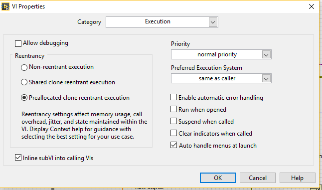

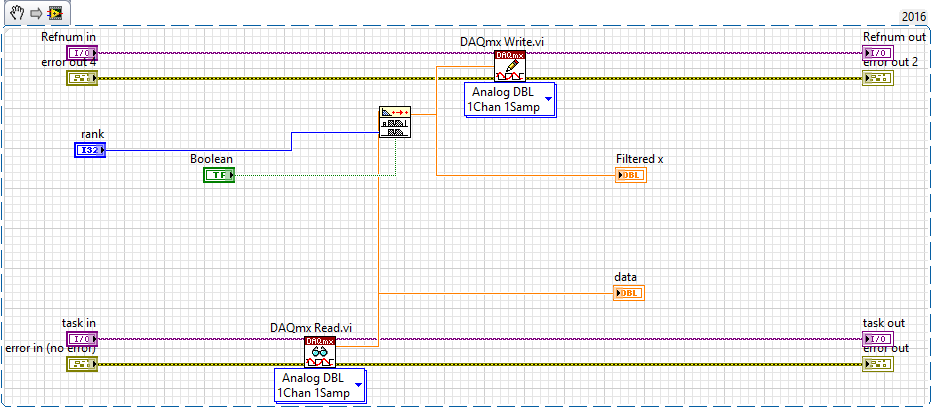

Where the ugly subvi created from selection is:
Why did I create that sub.vi?
Inlined!
For something as slow as 20kHz you should be easilly able to achieve that rate unless the UI thread bogs you down updating those charts (You could remove them after tweaking Rank's Value)
Rank then sets the delay between In and Out the tradeoffs are Higher rank = better filtering and more delay

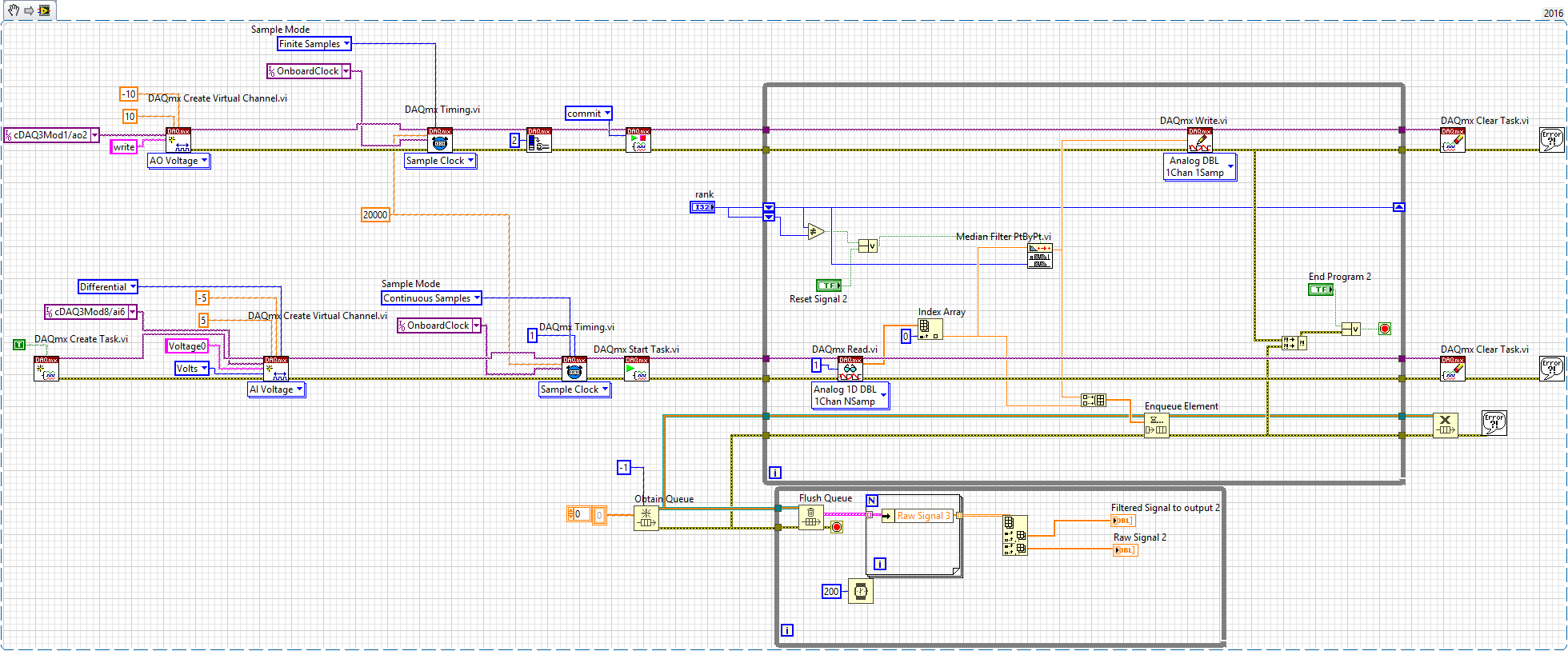

As a matter of fact I do.  This is obviously the AO task.  Replace the Start Task vi with DAQmx Control Task.vi and wire the input to a "Commit"  That places the task in a state as close to run as possible and will really lower our overhead inside the loop.  It should "Auto-Start" with the Write.vi write one sample and return to the commit state every iteration of the loop. Check here for a great peek at DAQmx State Transitions and Here for the duct-tape-required tour.
We should rethink the AI task and change it back to Contineous Acquision, sample rate = 20000 and Samples to read =1. Use a read 1ch n samp dbl The loop will pace with the AI having 1 sample available.  Index the first element (there will only be one)  run it through the filter into the AO write.
The trick here is we need to iterate faster than 1/20kSec so that the input buffer does not get a backlog (that will eventually throw another error) So, we need to have that loop doing nothing but DAQmx related stuff.  So, Add a Queue! and queue the Raw and Filtered Doubles up for display elsewhere  Use the trick found here Serendipity rides again of writing to the graph from a "flush queue" to limit the burden on the UI thread Flush it every 200ms or so.

Thank you for your help, you got rid of those errors but now I am running into one more, since I'm not sure If I have implemented your suggestions correctly. I've attatched the VI snippets, does this look right? I'm now running into an error:
Error -200609 occurred at Stand Alone Optical Drive.vi
Possible reason(s):
Generation cannot be started, because the selected buffer size is too small.
Increase the buffer size.
Selected Buffer Size: 1
Minimum Required Buffer Size: 2
Task Name: _unnamedTask<21>
I tried completely removing everything with the Queues (since I haven't worked with them before and I figured that would likely be a source of my mistake), but I still have the same problem. Do I need to add a configure buffer function?

Actually not half bad!  I'm a bit surprised by that error!  The Wait was the worst of your mistakes.  The DAQmx read will pace the loop.  I fixed your queue datatype.
Give this a shot.
You May need to transpose the 2D array in the display loop.  You'll know if the charts look really odd
