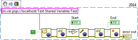

I'm pretty sure that the Open Variable Connection is designed for Network Shared Variables, not Single Process Variables.  The Link to Variable is just the URL to the deployed variable.  I created a tiny project with a Boolean Shared Variable called Test -- if I made it a Network Shared Variable and deployed it to my PC, I could access it just fine as the Snippet illustrates.  But if I made it a Single Process Variable (and got rid of the Network Shared Variable), I got Error -1950679035 on Open Variable Connection, Unable to located the SV on the Shared Variable Engine (which makes sense, it is not deployed there).  Incidentally, when I run this code, Start is False and End is True, as it should be.

I found basically the same thing.  What I was not sure of was whether you should be able to read Single-Process Shared Variables.
Looking at our help documentation for the Open Variable Connection, it opens connection to a shared variable.  The documentation for the Read Variable function is more specific and says that it reads from a, "network-published shared variable, I/O variable, or I/O variable container" which a SPSV is not.
https://www.ni.com/docs/en-US/bundle/labview-api-ref/page/functions/open-variable-connection.html
https://www.ni.com/docs/en-US/bundle/labview-api-ref/page/functions/read-variable.html
Based on the Read Variable's help documentation I would say that it is probably not possible.  The problem I had was what the URL of the variable would be.  In the multivariable editor the URL is just ./<Library>/<Variable> and it would not be ni.var.psp or ni.var.io becuase the SPSV do not communicate using PSP and are not IO.
