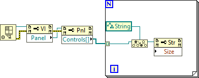

Sizing a control remotely.
I can remotely disable the control "I_SOUR_STEP" with the above.
How would I change the size of the same control remotely?
Thank You
Chris

Labview doesn't know what kind of control this is, so it will give you only the most general list of available properties. Use "to more specific class" to have labview handle your reference as the known control type. That should give you the appropriate "size" property.
Since you are searching for a specific name, I assume you know the control type.
Using Labview 2022, Windows 10

Thank you!
Chris
