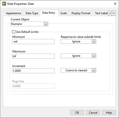

To generate less events, you can set the increment property.  Your slider should "snap to" the nearest incremented number, allowing you to more easily control the value.

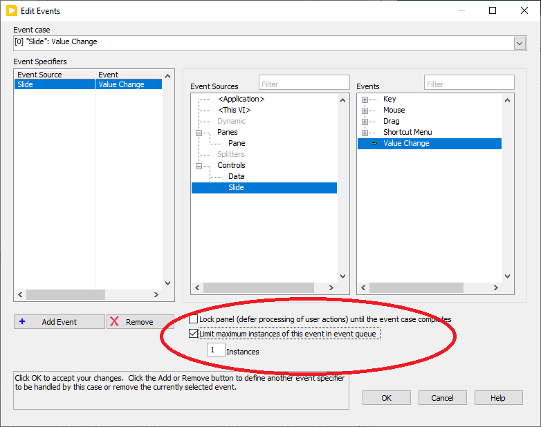

Simply change the event to not lock the panel and have an event queue size of 1.
(And thank me for this idea!) 😄 (other workarounds are in the idea discussion and here for what we did before)
edit:
Increment value set to .01 - still triggers quite a few events.
I was able to scroll from 0 to 70 in 2 seconds and triggered 150 events.  Includes time it took me to mouse from play and to click stop.
Message 9 of 20
(3,698 Views)
Yes, if the event case is basically empty and can be repeated in nanoseconds. As soon as the event does some actual work, many intermediary changes will be discarded and only the last one kept.
