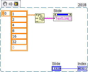

Thank you both for your replies.
I seem to be having trouble inputting the string format into the TextLabel property node.
I've attached a picture to try and clarify again.
Could it be that I've somehow got to change the output to an input? If so, how would I do that?
Thanks for your help, I really appreciate it. I'm relatively new to LabVIEW.

Yep, right-click it and select "change to write".

I've been racking my brain over what I'm doing wrong here, I'm really not sure.
I keep getting an error every time I try and run the VI
Message 8 of 9
(6,824 Views)
I keep getting an error every time I try and run the VI, I've attached the error and my block diagram.
