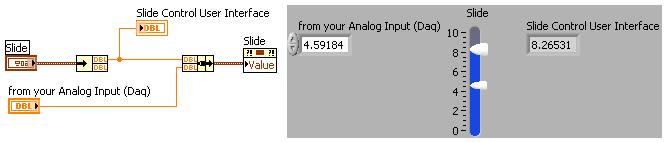

I would check out this post.
Disable Single Slide
I like the event based approach they took and would have recommended something similar.

@apok wrote:
double needle is a cluster...
Spoiler
I tried this approach already (as I mentioned I could do in a previous post) and it still gives the user acces to the feedback slider.  If they wanted they could just grab the slider and move it to an arbitrary value in between feedback steps from the system.
Message 9 of 13
(5,417 Views)
I definitely works but I was looking for something less bulky.
I do like the simplicity of the idea Don_Phillips but not quite what I was looking for.@Don_Phillips@Don_Phillips
