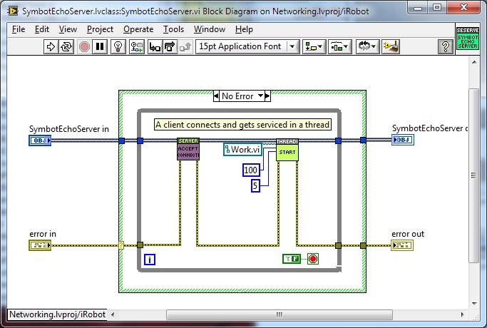

The sbrio waits for incoming connections and spawns a worker thread(VI server call Loop.vi, that is hidden, and the method name is Work.vi) onto a new tcp connection pair and then goes back to listen for connections, see the image below:

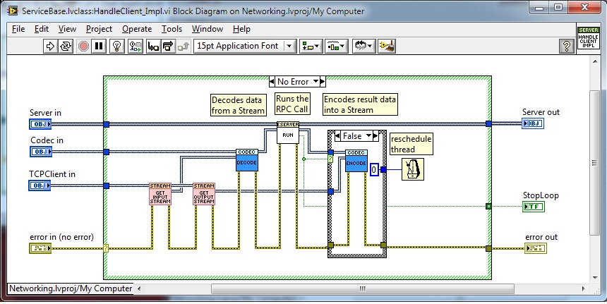

In the Work.vi, the client gets handled, depending on what client Object type:
Finally where the wheels hit the ground, we have a Codec encode/decode pair that handles the incoming stream, in this case a socket stream.

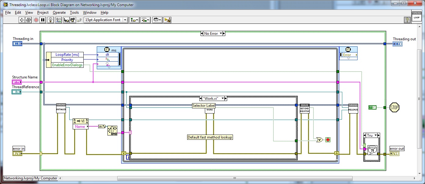

 All client processing takes place in a timed loop, that looks like this:

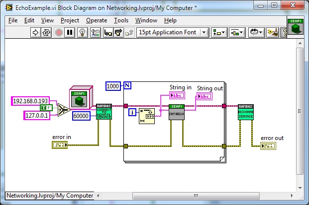

The client code looks like this, it just echo back a string 1000 times, the client also uses the encode/decode pair, but in reversed order.

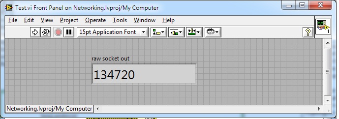

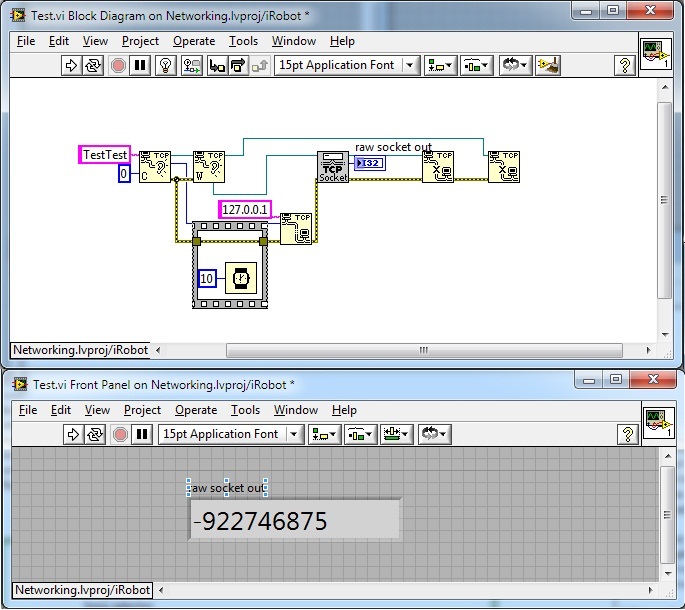

Here are the screenshot of the LV code running on the SBRIO:
And here from the Windows:
Negative Socket references, cant be a good thing. Probably the conversion between the BSD sockets and the Windows ones aren't as simple as this VI makes us believe?
Roger
I wouldn't worry to much about the sign here. I have no idea how VxWorks implements a socket so it could internally be a large unsigned number but when displayed as signed then it shows negative.
Now what you can try is to modify the VI you got from an earlier post. The VxWorks kernel does export a setsockopt() function that can be accessed and quite likely works just as in any other Berkeley based socket. However the VxWorks system does obviously not use the some module names as Windows. So you may want to try to change the library name to "vxworks.*" or maybe simply "vxworks" in the Call Library Node for the setsockopt() call and see if that does work. It's a bit of a guess here but anyhow worth a trial. Also you will certainly want to change the calling convention to C decl since VxWorks most likely doesn't support stdcall at all.
