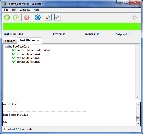

If you are using OO then you might consider the free VI Tester from JKI as an alternative. This package is more closely aligned with the xUnit testing methodologies and you can manage how the tests are executed.
I ran a quick test using VI Tester from JKI in LabVIEW 2013. The response is a lot faster although more effort is needed to create and maintain tests; you will also have to rely a lot on community support. Just another option to consider if test time is really of a large importance.

@tyk007: I'm impressed, JKI seems to be a lot faster. Thanks!
Do you know by any chance if JKI can deliver some coverage statistics?
